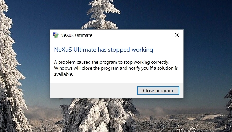

I wanted to attach the message that accompanies Nexus Ultimate crash as it exist on my laptop.
This is what I've learned about this behavior.
It happens on my HP Envy laptop, sporting Windows 10 Evaluation copy: 14379. It occurs if I plug in my electrical cord, a printer, or an external disk drive - every time. It is a hard crash; I cannot reload Nexus unless I reboot my system. When I try and reload the program, I see it in my task manager's list, but the dock never appears on my desktop; I have to reboot the system in order for the program to work as it should.
Of course, this is an evaluation copy (OS) I'm writing about here. I've opted to wait for any other updates until the final version is released on August 02, 2016. Hopefully, whatever is causing the crashes, will be fixed in that build.
I thought I would share my experience with this crash as I've experienced it here.

Thanks for the screenshot. That dialog doesn't tell me anything useful, but something else you said does: that it occurs 'every time'. This goes against what you said previously. :)
If it occurs every time, then we can try to isolate the cause.
Of course, it is understood that you are running an Insider Preview build of Windows 10. Normally it is a really bad idea to try to diagnose issues in beta versions of Windows, for the simple fact that the bug is likely in Windows itself and not in the application.
However, this time I am curious as to why plugging and unplugging stuff on your system would cause Nexus to crash. Even if this is an issue corrected in later Windows builds, perhaps I can learn something out of this that would make Nexus more crash-resilient.
So, if you're willing to help me get to the bottom of this, here is what you should do:
First things first: make a backup of Nexus Ultimate settings as they are right now. Open Nexus Ultimate Preferences, go to the Advanced tab and click the Backup button.
This will enable us to play around with Nexus settings at will safe in the knowledge that restoring it back to the way it was is just a 'Restore' button away. :)
Also, if you can, please send me the backup file to the Winstep Support email address so I can have a look at it and try your settings on a Windows 10 machine here.
Once you've done the backup, we can start trying to find the culprit. Since you're running Nexus Ultimate, I assume you're also using the Shelf (tabbed dock). So lets try to see if this is Shelf related or not: open Preferences and go to Docks & Shelves tab. Unselect the 'Enabled' check box for the Shelf and press OK.
This will make the Shelf disappear and will take it out of the equation.
Now plug or unplug something that would cause Nexus to crash. Does it still happen? Please let me know.
As for having to reboot after a crash. My guess is that this happens because, even though Nexus Ultimate crashed, it is still hanging around in memory for some reason. Next time it crashes, before trying to launch it again open the Windows Task Manager, go to the Details tab and look for a nexus-ultimate.exe process. Kill it if you find it and you should now be able to re-launch Ultimate without having to reboot your machine first.
