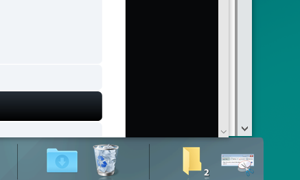

By the way, I was just wondering if it's possible to make the window limit to be the dock except when the window is in full screen. just like in macOS
File comment: Something like this
Open the dock's Properties panel, go to the Position tab and enable 'Prevent maximized windows from overlapping the dock'.
Note that normal, non-maximized, windows can still be made to overlap the dock. That is normal behavior under Windows since you can make them overlap the Windows taskbar too.
That's kind of the opposite of what I was thinking, but thanks anyway :o
