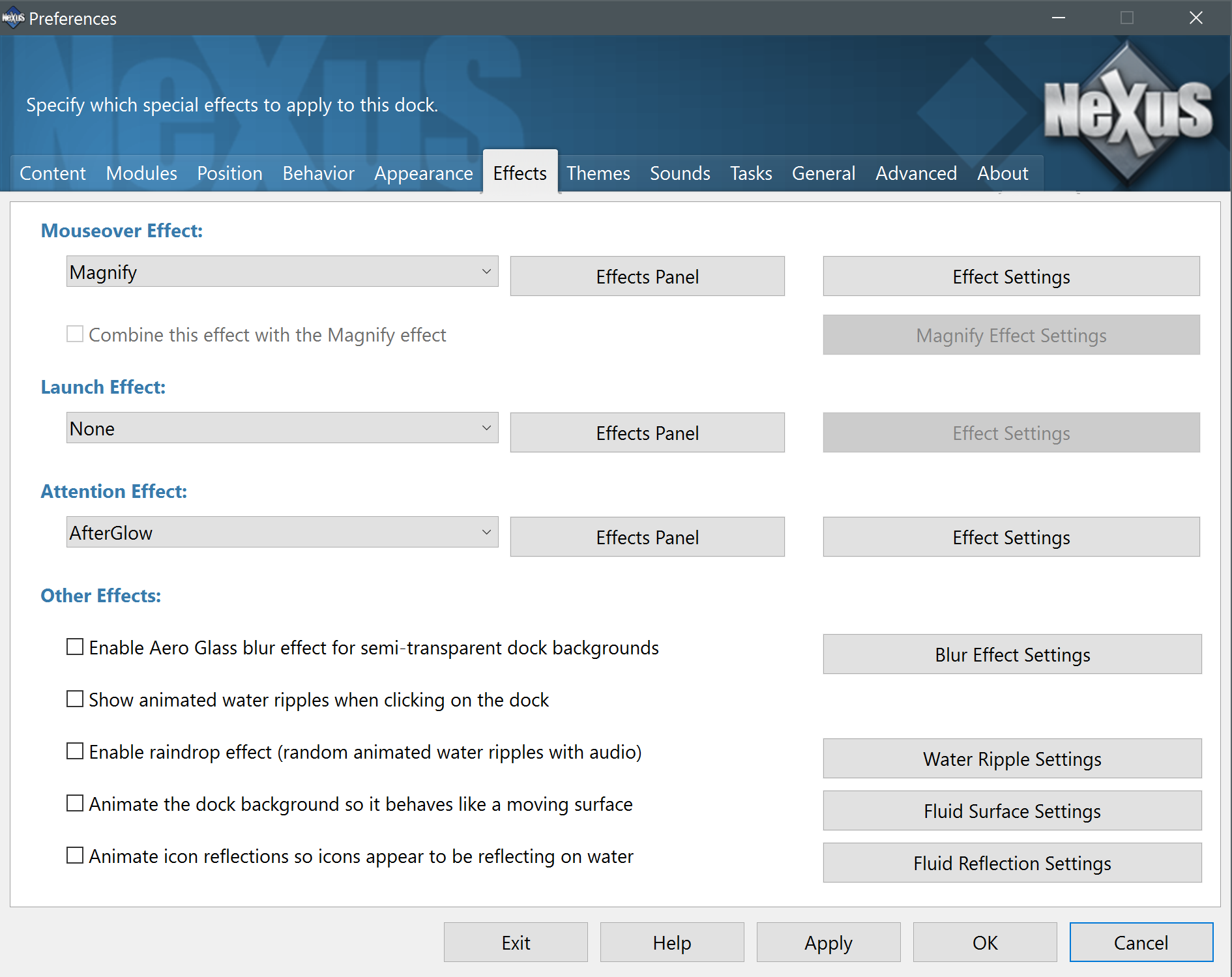

So I am having an issue with the dock instantly vanishing whenever I click on any icon to launch an application. It wasn't doing this a couple of days back. Instead, it would descend and zoom inwards but I can't get it to do that any more.
The only changes I made to the preferences since the time it worked correctly were in the Effects dialogue where I set the Attention effect to AfterGlow. The effect never worked so I figured maybe it is reserved for the paid version. However, changing the effect to anything else made no difference.
If I upgrade to the paid version will it solve this issue?
File comment: Current settings
And this, I think, might be because you don't really understand what the Attention effect is for.
I've seen it a lot of times on videos of random people explaining Nexus settings: they do really well until they get to the Attention effect, then they clearly show they don't know what that is for.
The Attention effect - as the name implies - is only played when an icon is trying to get your attention. This includes the weather module currently retrieving weather info, the clock module synchronizing the system time with the atomic time servers, the email module checking for new messages, and when a task list icon (icon representing a running application in the dock) needs your attention (the equivalent to the flashing Windows taskbar button, except in Nexus you can choose more effects than just flashing).

@ seeker
Thanks for your input. I unchecked all the options in the auto hide settings but the dock still instantly vanishes on click, and yes, I did apply the changes before closing the Nexus settings window.
@ Winstep
Yes, you are correct about the Attention effect however it brings up another question: for those who, like myself, use auto-hide, it will always be impossible to see the attention effect so why is no 'None' option available in the settings menu? Or are you saying that the dock will automatically make itself visible if the attention effect is triggered (in which case it doesn't work on my PC)?
