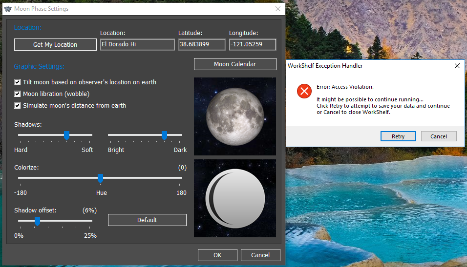

Guys, I need your help troubleshooting something that I can't reproduce here:
Open the Moon Phase module settings panel and leave it open while you work on other things (just forget it's there for a while).
Does WorkShelf or Nexus Ultimate eventually crash with an Access Violation error after a while?
Please report back Yay or Nay.

I have tried the Moon settings thing and got a crash in a few minutes. I am running Windows 10 64 bit Home.

Jorge. About 10 minutes in . . . FYI, I hit retry and got the message a second time, hit retry again, and was able to continue.

This has been driving me up a wall. I have been unable to reproduce on my Windows 7 machine, but was finally able to reproduce on a Windows 10 VM after a few minutes.
It seems related to OS version at first, but it might be something else: Paul, Vlad, what are your screen DPI settings?
Same thing here, also as per Paul. Win10 Pro 64bit, 125DPI. Tried it specially, don't normally use it. :)
120 DPI

Right. What about you, Paul?
I was able to reproduce the crash on the Modules tab of Nexus Ultimate too, on the Windows 10 VM which I run at 150% DPI. For the time being I suspect this has something to do with GDI+ and screen DPI, and not so much with Windows 10.
But if it has something to do with creating the moon frame bitmaps, why doesn't the Moon Calendar crash as well, with it's big animated moon?
