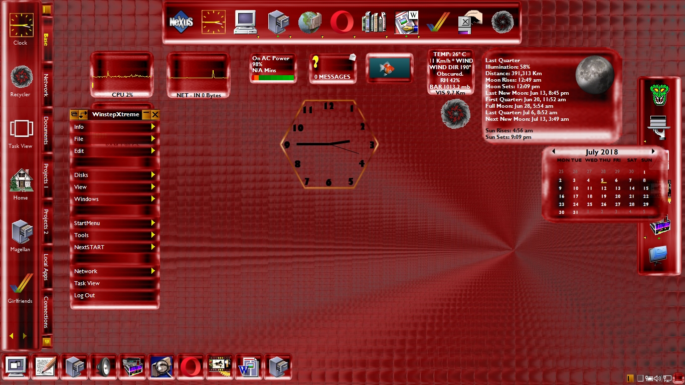

As can be seen in the attached screen grab, the vertical icon spacing in a vertical shelf can be a bit of a problem.
While both H and V icon spacing is fine in the horizontal version of this shelf, icons are much too far apart vertically in this vertical version. Changing icon spacing is not possible as v. spacing was already set to minimum, and h. spacing would just narrow the shelf and have no other effects.
Otherwise, no problems so far with the beta. Love that verticaal shelf. Think I'll have a two-row floating vertical one for my personal setup. Really floats my boat! ;)
Great job, Jorge.
The theme in this grab is an experimental WiP, with some bitmaps translucent. Recycler is the original NeXT 'Black Hole' one. All modules 100% scale except Calendar 80%. The setup is my 'experimental' one for developing themes.
Also, another problem not related to the shelf (nor the beta alone) can be seen here - the horizontal dock at the top. The dock bitmap is upside down!
How many lines of icon text are you setting for that Shelf? That seems to be the problem, i.e.; it's more than 1.
Also, another problem not related to the shelf can be seen here - the horizontal dock at the top. The dock bitmap is upside down!
Yes, the dock *automatically* flips bitmap backgrounds for docks at the top of the screen when one is not provided for that particular screen orientation - it also rotates them automatically for vertical docks, etc...
Anyway, if you don't want the bitmap to be flipped you can enable the 'Do not flip background for docks at the top of the screen' setting in Dock Properties -> Appearance tab.
Ah, forgot about that one! :) Yes, it's 2 lines. Fixed. But now longer labels overlap the tab and also are no longer centred under the icon, and the v. spacing is still quite large.
Yep, I know all that, and there are four separate bitmaps, one for each orientation, correctly named and all that and correctly configured.
Yep Jorge, I know, and it is enabled.
I think that simply, nobody's really noticed this before as there are few themes with separate bitmaps for all orientations. Apart from my own themes, only have seen comparable differential bitmaps in 'Atmospherica' theme - and there, too, the top one gets turned upside down.
Sometimes docks with 6 or less icons at the top are shown correctly - it seems to vary with different themes. The theme shown (and 'Atmospherica'), among others, will still show the bitmap upside down with six or less icons.

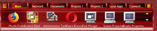

And here's that same dock and tab in h. floating shelf. Fine, except now due to the 1 line limit for icon text this in some cases overlaps. Ouch.
Maybe in the end best/simplest solution might be to have the icon text vertical to the left of the icon, i.e., same place it would be in h. shelf?

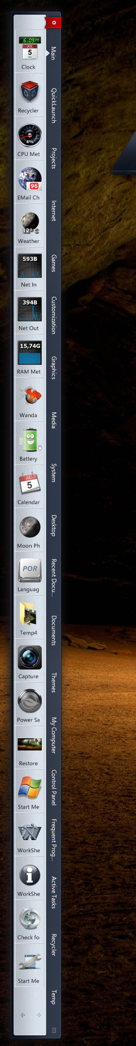

Ok, something is very wrong THERE. I can't reproduce it here, even with both the horizontal and vertical icon spacings set to minimum. So, it must be something else.
What is your screen DPI? Are you running multiple monitors, each with a different screen DPI? What is the Shelf scaling set to?
EDIT: As you can see, all looks well here:
