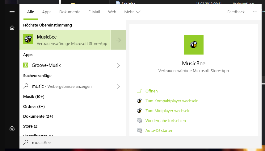

Haha, I get your point ;) . Do you have any proof that people got actually fired because of the Insider Program?
Have a look, in the current start menu there is, if you search for an item, not much of an option to choose from where to drag. It's the left side, yes. I can neither drag MusicBee nor Groove, or any other app.
Ah but your screen grab isn't actually of the start menu itself but of a search result dialogue. That may well be the problem why you cannot drag and drop from it.
MusicBee (no idea what that is when it's at home as would never use the MS Store for anything nor any of the apps) must be somewhere on the Windows start menu itself, and unless you have a ton of applications installed it shouldn't take to long to go through this to find MB.
LOL. Google "microsoft fired QA" and marvel at their immense stupidity yourself. :)
As Ric pointed out (and thanks for the picture, btw, or we would have been here a long time lol), that is Windows Search, not the Start Menu.
That's right, well, I used the start menu and typed, so for me it was still the 'Start menu', but it is also correct that I can, from the sole list in my start menu, drag and drop those two apps to my Nexus bar - thanks for pointing that out!
