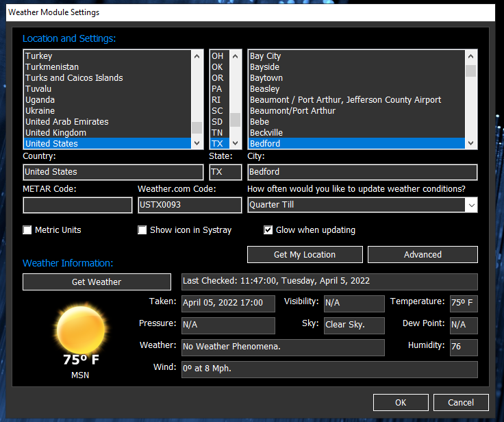

This is the log when it shows wrong and a screenshot of settings. It's 3:24 AM here.

Hmm.... There's an anomaly in the Weather Module Settings -
Last checked : 03:24:20 etc.
Taken : 08:45
If the most recently taken data were timed at 08:45, the time of the last check by the module should be 09:45 or 10:45 (depending on when it was actually first checked by the mod). It couldn't have checked at 03:24 and show a later time than that as the time the data were gathered.
Something very screwy there....

Yes, but if you look at the debug code which Tickles also included, you will see it says
observationtime="04:00:00"
So, I suspect this is a timezone conversion bug. Most weather feed providers supply the times in GMT/UTC (Universal Time Coordinated) but MSN seems to do so in Local Time (to the location). When the time is given in UTC it must be converted to local time so the user can see it in his own timezone.
I think this is an issue where the weather module thinks the observation time is UTC when the MSN weather feed is actually providing it in Local Time. Add to that Daylight Saving Time to complicate matters further, and this might explain the wrong icon (and wrong observation time).
I will have to look at the code.
EDIT: There is, however, something else that does NOT add up. You say the weather was retrieved at 3:24 AM (and that coincides with the time shown in the Weather Module Settings panel) BUT NOT with the debug code. The debug code says it's 09:42:28 GMT when the request was made, it does not match the minutes in the 3:24 time shown in the Last Checked field (plus the observation time is 04:00, regardless of that being local or not, again it does not match the minutes in the 8:45 time shown in the Taken field).
Are you sure the debug code you pasted was belongs to the same request at 3:24 AM? It does not look like it? :|
Can you please click the Get Weather button and only AFTER paste both a screenshot of the Weather Module Settings panel as well as the contents of the Weather.log file? This way we will know they are truly matched. Easier to figure out what is wrong that way.

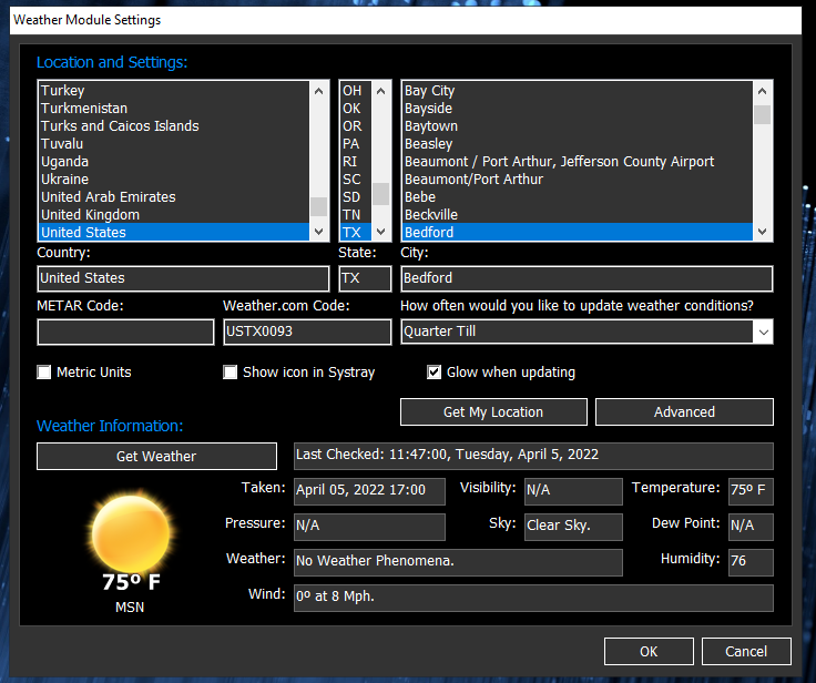

 Post subject: Re: Weather showing incorrect icon.

I got them very close timeframe earlier. Since I had to open the settings to get weather, they were done very close on my side. Here though is the same again done even closer. During the day it seems fine so far, it is just at night it has shown the sun when it should be the moon. So will post as needed to help you to help me. Thank you for taking the time and helping.
