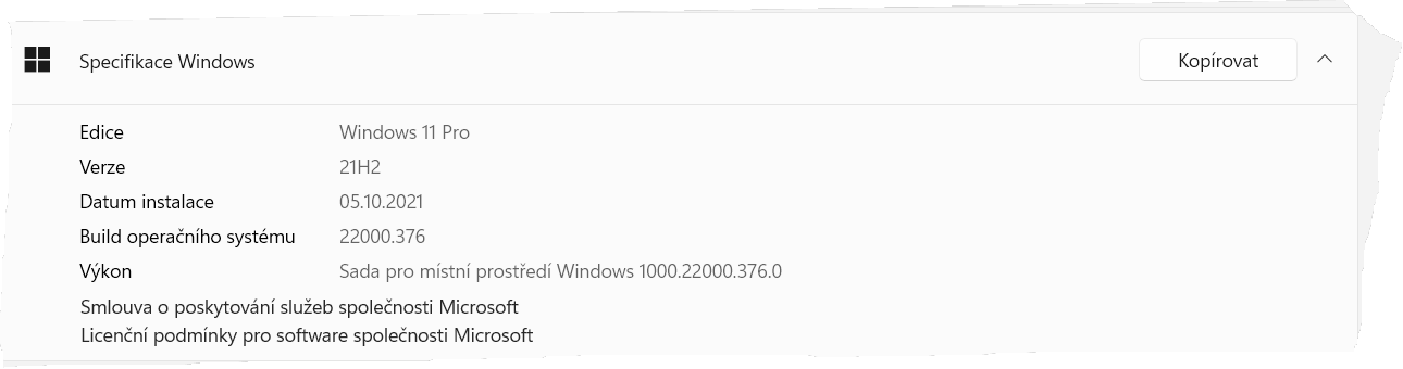

 Post subject: Re: Beta 22.4 cannot be installed on windows 11
PostPosted: Fri Apr 15, 2022 12:49 pm
Joined: Mon Jan 27, 2014 11:45 am
Installing help winstep update manager.Winstep Xtreme.Installing the end after downloading the file.Owning Windows 11 pro.
PostPosted: Fri Apr 15, 2022 6:59 pm
Posts: 13472
From the little information available on the web about similar errors, I suspect this might have something to do with the new version of the installer (InnoSetup) and the setup.exe file being marked automatically by Windows (don't see how it could have been done any other way) to run in compatibility mode for Windows 7.
Let's try installing the beta update manually to see what happens:
1. Download the Winstep Xtreme beta update from HERE.
2. Exit all running Winstep applications.
3. Unzip the file and extract setup.exe
4. Run setup.exe
Please let me know if you get the same error or if the update installed successfully.
VERY IMPORTANT: I need feedback from OTHER users running Windows 11. I need them to post here if this DID NOT happen to them.
Need to know if this is an issue specific to this user or something more widespread.
PostPosted: Sat Apr 16, 2022 3:47 am
Posts: 13472
Looks like there was an issue with the latest version (6.x) of InnoSetup (the setup application for Winstep apps) where it could pop up a 'Requires Windows service pack 1 or later' message and abort installation.
Although I cannot confirm this, from what I read it seems this only happened when trying to install on a Windows 7 system OR (and this is the really bad part) on a system running a LATER version of Windows but which was upgraded all the way from Windows 7 instead of a clean install (e.g.; you go to Windows 10 by upgrading from Windows 7, then to Windows 11 by upgrading from Windows 10).
Due to this - and also because version 6.x of Innosetup is no longer compatible with Windows XP - I have downgraded the installer back to version 5.x for future releases. Nothing lost, really.
