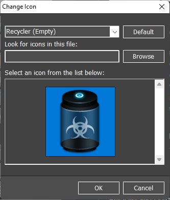

The Recycle Bin module has TWO images you can customize, one for each state: empty and full.
My guess is that you are only changing the image for ONE of the states.
At the top of the 'Change Icon' dialog for the Recycle Bin, you need to switch from 'Recycler (Empty)' to 'Recycler (Full)' and vice-versa.

i repeat that the problem appear only with recycle bin full, in this condition is impossible change the icon.
i dont know if is a specific procedure to do but that's element dont work
