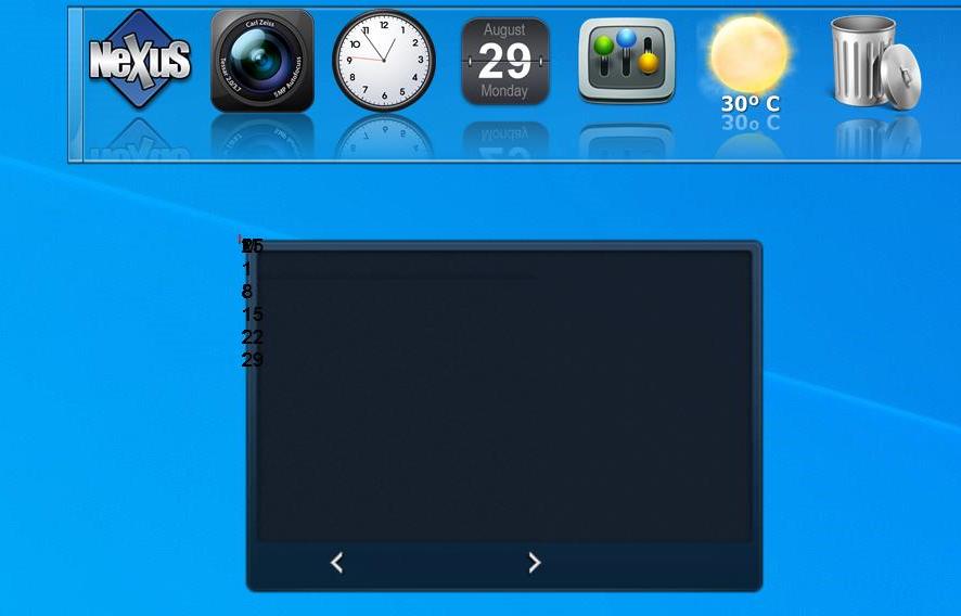

Hi there,
sorry for maybe it is not right place to ask,
but I have the problem to SEE the calendar when click on the dock icon (pic attached).
I'm on Nexus Ultimate and theme is Windows_7_Xtreme.
I tried Classic style with the same result.
BTW, I have screen resolution 3840x2160, could it be a cause of the problem?
Ugh. That is actually a bug in Nexus Ultimate.
Right click the calendar icon in the dock, open the Theme sub-menu from the context menu that pops up and then select 'None'.
EDIT: already fixed this bug for next release.

Joined: Fri Aug 28, 2020 9:40 pm
Thanks, setting to None fixed the problem!
