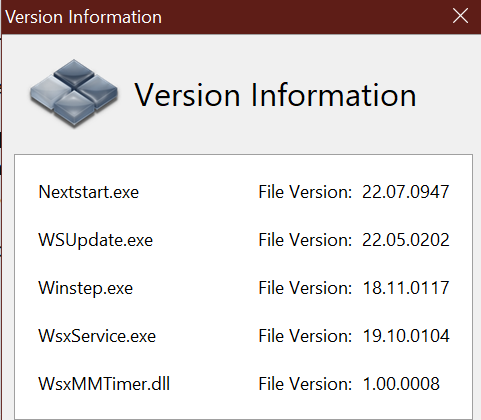

I attached a screenshot with the version information.
It happens with nearly all apps that change the resolution. The amazing fact is that it happens only when switching to specific resolutions - not to all...
And to make it more irritating is the behaviour different if I use the internal or external monitor (internal native resolution on my MSI 2560x1600, external 4K). But for some games I would prefer a lower resolution - or the highest resolution is not supported - by older games for example.
