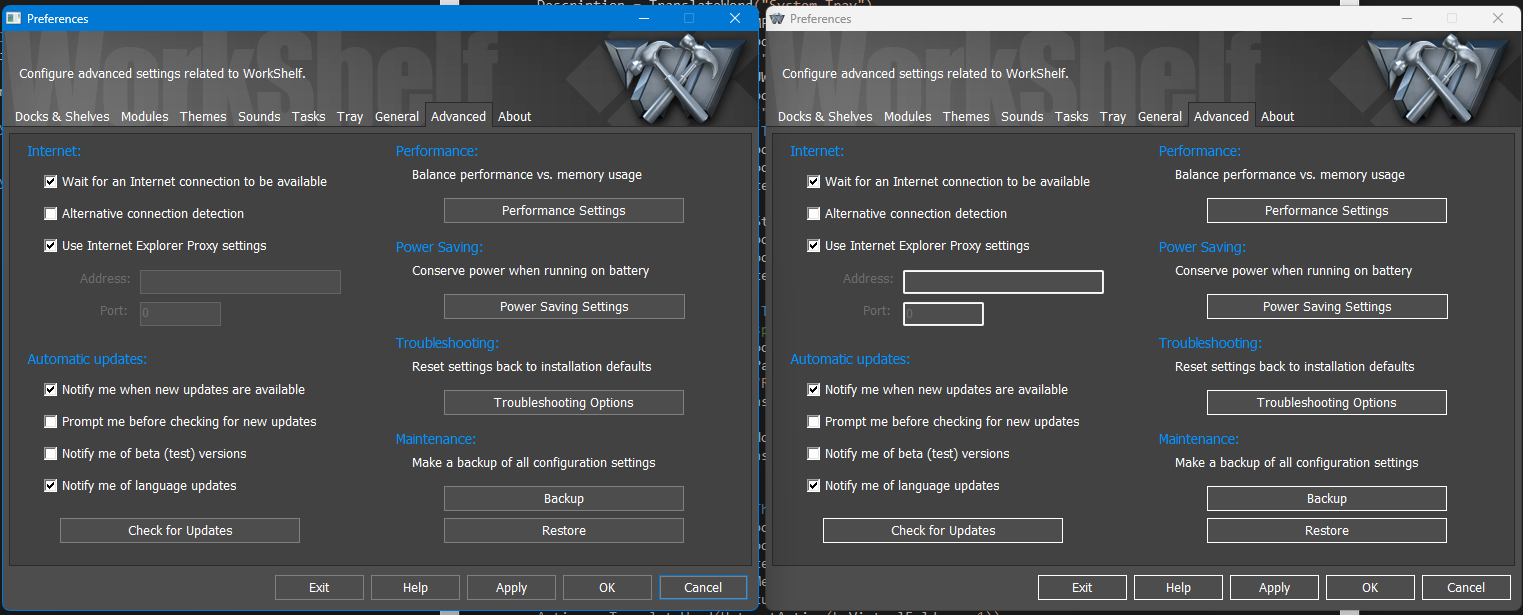

While working on the per-monitor high DPI compatibility (and other things), decided to tweak the GUI a little bit as well (new on the left, old on the right). Instead of a contrasting white border on buttons, etc, a more palatable grayish border.

The old on the right is definitely preferable to most people with some sort of visual impairment like myself - much clearer and easier to see.

Ah, so are the high contrast Windows themes, but most people will stay well away from them unless they have some sort of visual impairment.
I think the grayish border for buttons etc blends in better with the rest of the UI theme (and Windows 11 itself) than the high contrast white border.

Agreed re: the high contrast themes - actually, no help here, quite the opposite, they'd be harder to deal with with my particular impairments.
Actually, as concerns old vs. new UI, looking at the image full size - which I hadn't before! :/ - yeah, have to agree Jorge, the new does work better, even in Win 10. :)
