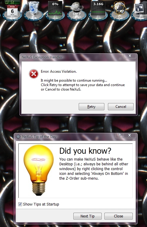

I am running Windows Vista-64 Business on a Intel Quad CPU with 8 gig of ram. I have occationally had the problem of having the error message: "Error: Access Violation.". I am given the choice of Retry or Cancel. I usually just select Cancel and restart Nexus. The message, if it appears, always shows up just after the Nexus Tip Of The Day message appears.
I am running Windows 7-64 Ultimate on my computer at home. This problem does happen as well. There are no messages in the logs to show what might have been the problem. The only thing that may be common to both my work and home computer are that they both have Intel CPU's and both are running x64 operating systems. On my home computer I run with full privileges (UAC off) so there shouldn't be any problems with accessing date files.
I did take a screenshot of the error message in case that may help provide some clue. This is the free version of the Nexus Dockbar. Please let me know if there is other information that I can provide to help find this error.
Thank you for your time.
Terry Steadman
File comment: Error message from Nexus startup.

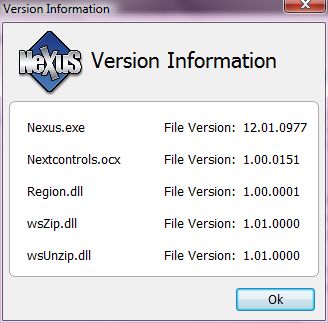

File comment: Version information for Nexus.

The error message comes up very fast when starting up Nexus. Just after the Tip Of The Day is shown, the error message pops up over top of it. In the picture, I had moved the error message so you can see the Tip Of The Day in case there was a relation.

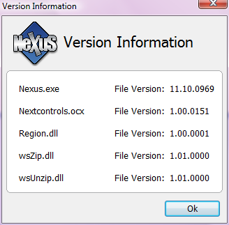

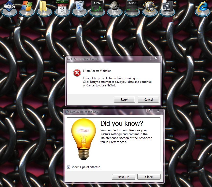

I have applied the patch as you have suggested. Unfortunately, the toolbar had given the same error: Access Violation again this morning. The error message does pop up quickly after the Tip Of The Day. I don't have the time to close the Tip Of The Day message actually. Is there any way to turn on a debug log that could be used to help identify the problem for you?
I have attached the version information and the error message that I had received. I have also moved the error message so the Tip Of The Day could be viewed in case there is a connection.
Thank you for your help.
Terry Steadman
