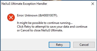

I originally bought Winstep Xtreme on version 12.2 but got this error when right-clicking an item in a tabbed dock.
Error: Unknown (&H0001007F).
It might be possible to continue running ... etc...
Clicking "Retry" does not work and just comes back with Nexus not responding. Cancel works, but then I need to reboot the computer to get workshelf back because just trying to reload it from the start menu doesn't do anything.
I just bought the 2-5 computer pack of Nexus Ultimate 16.3 and the problem is still there. This is exactly why I asked about trying out the most recent version before committing to purchase it, but got no reply to my email.
Can anyone offer any suggestions about this? It doesn't happen all the time, it's about every 2nd or 3rd right-click on an item. Clicking an item does not cause any problems. But it's very annoying when I'm trying to clean up tabs.
File comment: Error dialog

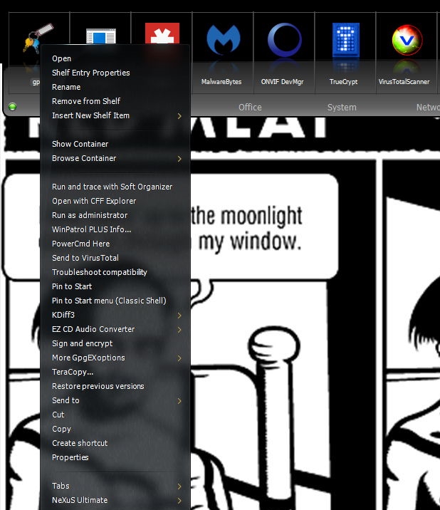

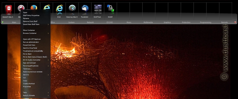

It happens randomly when I right-click a shortcut to an executable. Right-clicking a missing file to remove it seems to work fine. It's not one certain shortcut that causes it, seems like any exe shortcut will cause it. Here's the screenshot of the menu before it crashes.
Several of these same third party extensions are also installed on other machines that do not crash so I'm just trying to find the ones that are not common across machines.

Ok, see all those options on the context menu just below 'Browse Container'? The 'Run and Trace with Soft Organizer', 'Open with CFF Explorer', etc?
The fact that those appear on the right-click context menu shows me that you have NOT set the 'Show full context menu options' to 'Never'.
If that option is properly set to 'Never' the only options you see in the context menu are those above 'Browse Container' (included) and those below 'Tabs' (included).

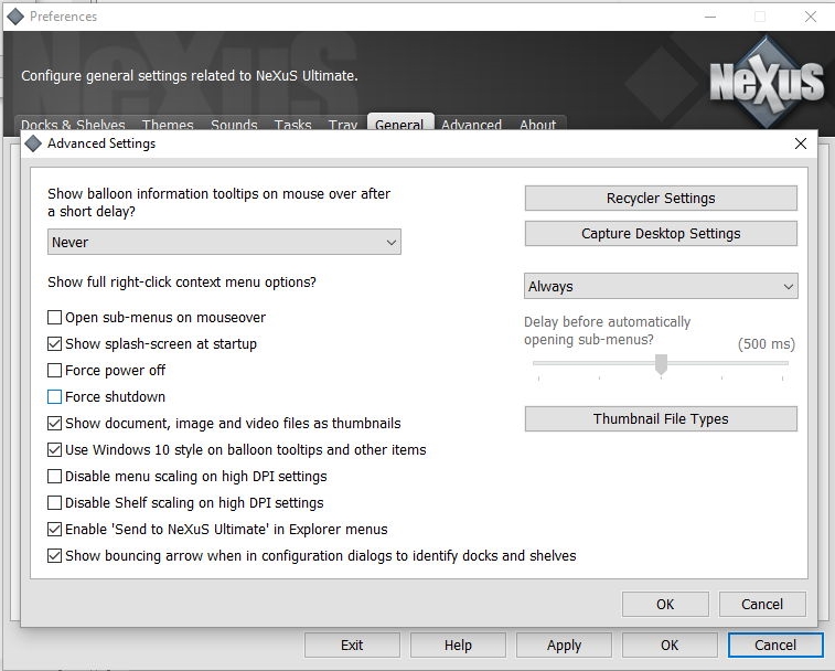

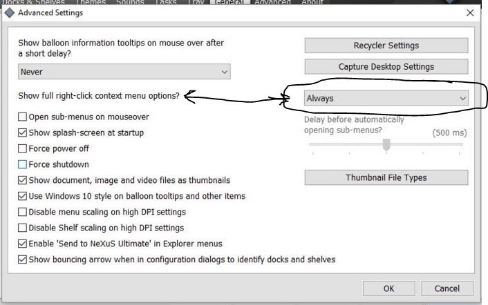

ummm .... but I did ... here's the preferences screen.

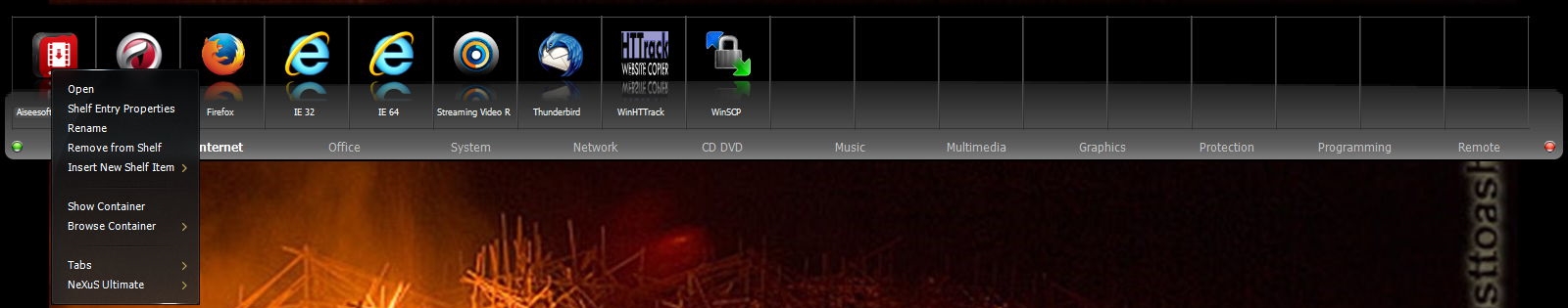

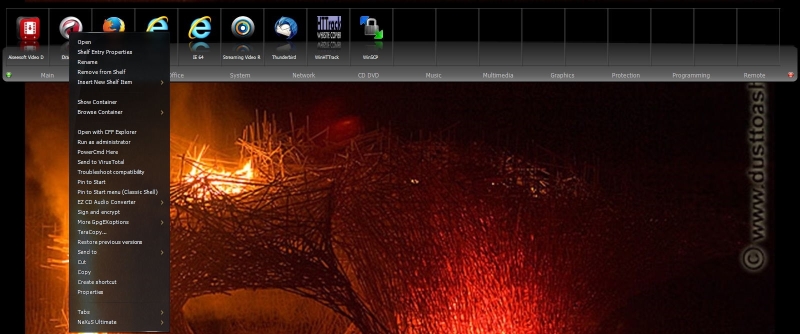

But here's something strange ... right-clicking the first icon on the tab brings up a different menu than the second and beyond icons. oops ... scratch that ... first and last icons show the short menu, all in between show the long menu. No ... scratch that too. Some right-clicks show the short menu, some show the long menu. It doesn't seem to matter where they are located.

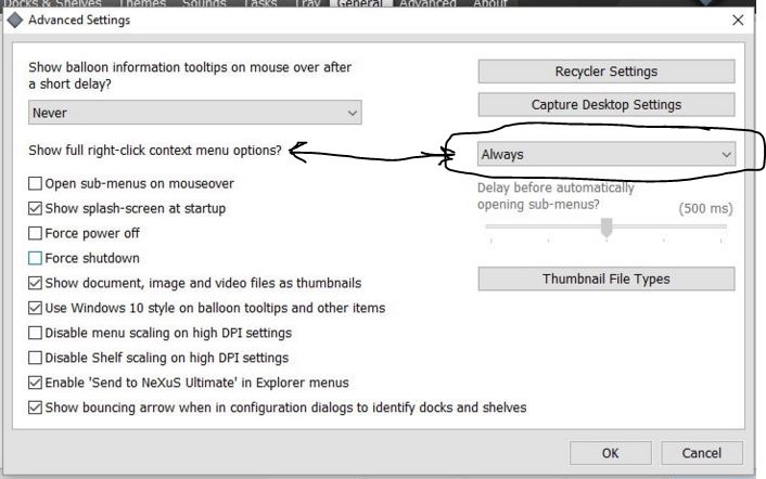

You're confusing the setting for 'Ballon Tooltips' with the setting for 'Show full context menus'. The latter is at the right of the dialog and is still set to 'Always'.
 Post subject: Re: Unknown Exception when right-clicking
PostPosted: Sun Mar 27, 2016 4:47 am
Posts: 46
You may want to take another look.

Yeah, I noticed that and thought that might be the case so I set that to Never as well. That's when I started getting the short menu on some, long menu on others.
PostPosted: Sun Mar 27, 2016 5:00 am
Posts: 13160
Ok, now *I* am getting confused lol. :D
Can you please set the Balloon Tooltips option to 'Always' and the 'Show full right click context menu options?' to 'Never' and then post a screenshot of that dialog so I can confirm the settings are correct?
PostPosted: Sun Mar 27, 2016 5:12 am
Joined: Sun Nov 11, 2012 1:52 pm
Posts: 14
hmmmm ... ok, and now I'm confused. I set the left combobox to Always and the right to Never. Clicked OK, then Apply. Then went back to More Options to do the SS and the right combo was back to Always. Tried it again, same result.
