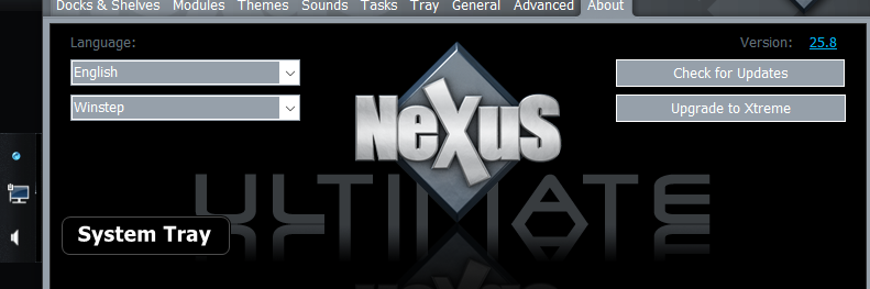

Unfortunately the system tray hasn't appeared. You can see in the screen shot that I still just see the blue dot (the Nexus bar is on the left side).
I've rebooted. And I've tried creating a new dock that shows the system tray, but same outcome. Anything else I should try?
Yes, I can see it is still using the "replacement" system tray.
I don't use Explorer Patcher. I assumed that if it was indeed working when the Winstep application queried Explorer about the number of icons in the systray it would return something other than 0.
If it returns 0 the application assumes it is running under a version of Windows 11 that does not allow tray icons to be retrieved anymore (and that Explorer Patcher is not running either) and uses the "clone tray" version instead.
I'll look at the code again to see if I might have done some mistake, but in the mean time please post a screenshot of what your real system tray looks like in the Windows taskbar (together with the tray expansion area, the pop up you get when you click on the blue arrow in the dock and in the up chevron in the taskbar)
