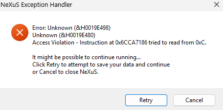

Hi can i know how to fix this error, everytime i open my laptop i have to keep pressing the retry button till it can load
Hi there. I know that message. I gather because you purchased the entire package you also received and used StartMenu Organizer?
This message is exactly as Jorge said. Startmenu organizer is separate from Nexus, Workbench and is packaged in with the full version. This is the 3rd party problem but it is not directly the application at fault.
What has occurred anyone can do by accident. You have likely and unknowngly moved a default folder in the organizer and Windows, speaking to Winstep reading menu location, spat the dummy. That's Winstep refusing to load the system folder because it has been moved and it is confused because it relies on system locations. I enclosed a link below. In a way it is protecting you, itself and your Operating system from being completely destroyed. As I said, anyone can do it. Startmenu organizer is so powerful it can move any program pointer/symlink/junction/shortcut.
Unfortunately, we all have to be aware of what is in the default user and leave it alone.
In a Command prompt or Powershell run the following...
Run:
SFC /SCANNOW...
when it finishes, run
DISM /Online / Cleanup-Image /RestoreHealth
Then reboot. That should fix the problem as it will rebuild the correct AllUsers menu directory structure.
Windows should tell you it found corrupted files and fixed them. So the issue is corrupted files.
THREAD ON IDENTICAL ERROR MESSAGE:
viewtopic.php?f=2&t=14062
IF you intend to continue using StartMenu Organizer, avoid relocating ANYTHING in this folder:
C:\Users\Default\AppData\Roaming\Microsoft\Windows\Start Menu\Programs
Look at them and make note if you will keep using it.
It took a little while for me to work it out because there's not any real documentation on the &H00 error. I backtraced what I did that was different that would cause a system error message like that. Any other applications that rely on the roaming default menu locations would have also eventually spat the dummy.
Event viewer should also assist in locating the error if you think it may not be the same thing.

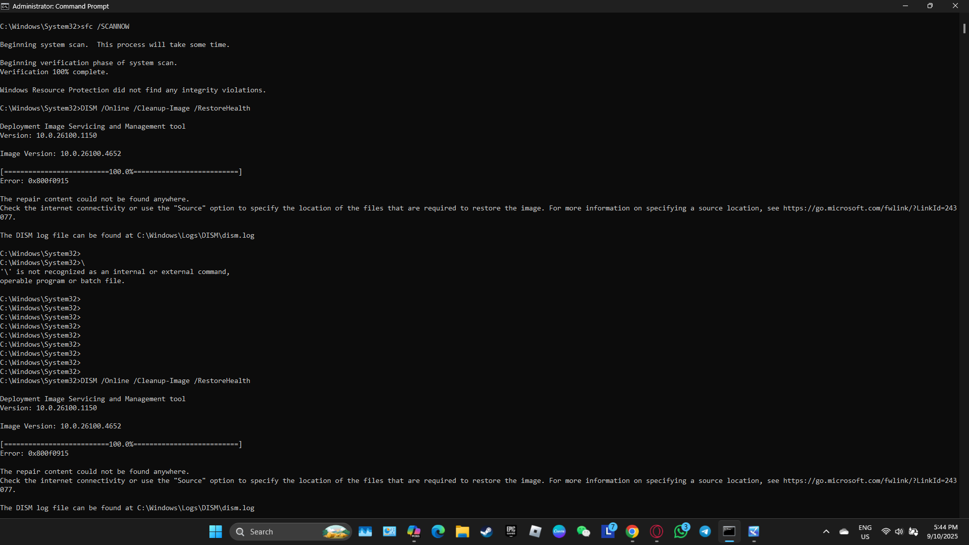

Hi, im using the latest version, and following the src step,it came out this
and still didnt fix it, i still have to keep pressing retry

Posts: 980
Ahhh... Uninstall and reinstall. Windows is fixed but it would have said files were corrrupted and fixed them. The files in Winstep would also have been corrupted. If that does not work., I apologise but I will be surprised if it does not. And do not automatically open something, reboot.

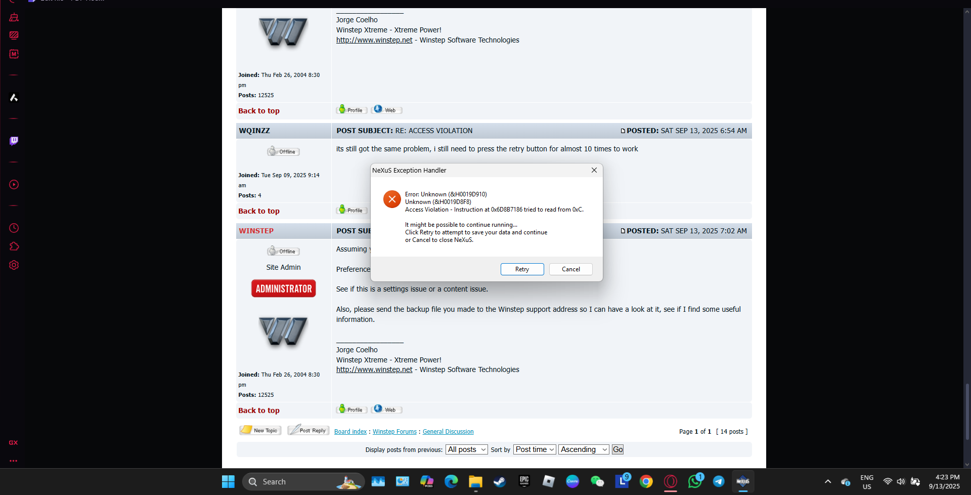

PostPosted: Sat Sep 13, 2025 8:26 am
Joined: Tue Sep 09, 2025 9:14 am
Posts: 12
Still not working after i reset the settings and for the backup files, this website doesnt allow wbk file
