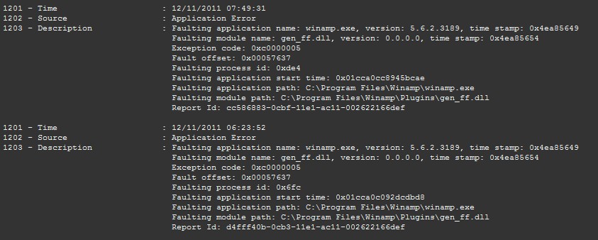

Does this help?

Have you seen the pic I added afterwordsin my previous post ?

Try Googling for 'gen_ff.dll error', I get quite a lot of entries for that.

I did some testing: apparently Winamp´s modern skins are incompatible with Nexus,(or is it vice-versa ?), at least on my machine.
Strange because it works perfectly on my other machine.(Win 7 64x)
I will keep Nexus as it is a great software & launch Winamp from the Quick Start with my semi-transparent skins.
Thanks again for your time & efforts.
