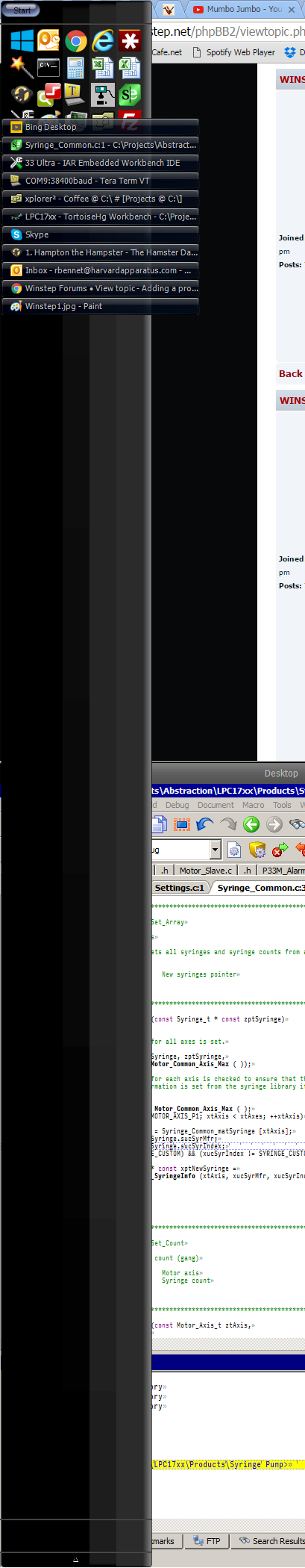

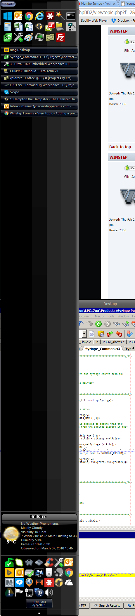

I uploaded three images. The first one shows my normal taskbar. The second shows it just after a Quick Launch rename. The third one shows it after the taskbar was allowed to autohide once after the second image.
Part of the workshelf can be seen at the bottom of the top screen. The Nexus is in the upper right corner of the top screen but not visible because of the cropping.
The taskbar spans two screens on the left side of a four-screen configuration. So you'll see the first screen in the upper half and the second screen in the lower half. There are two more screens to the right of the ones shown for a total of four screens. The screen configurations are:
So after renaming a Quick Launch item the taskbar loses the Weather module + system tray, and the tasklist extends horizontally beyond the taskbar? Wow.
I think 'losing' the weather module is what is causing all the weirdness.
How are you renaming a Quick Launch item? Step-by-step, please.

 Post subject: Re: Adding a program to Quick Launch in the Workshelf
PostPosted: Mon Mar 07, 2016 5:11 pm
Posts: 84
I just noticed there's a very narrow window of time where the taskbar appears corrupted. Apparently the taskbar is undergoing some sort of refresh when the rename occurs. Maybe because the Quick Launch appears in the taskbar as well? I should probably remove that since the Workshelf supplies all my Quick Launch needs.
I removed Quick Launch icons and now the taskbar quickly displays corrupted (image 2) and autohides on its own. Same result at the end (image 3).
PostPosted: Mon Mar 07, 2016 5:27 pm
The Quick Launch section in the NextSTART taskbar is a mix of Windows Quick Launch icons and NextSTART hotspots.
Because of this, the Quick Launch folder has a 'watchdog' placed on it which automatically notifies NextSTART when the contents of the Quick Launch folder have been changed. This usually means a Quick Launch shortcut has either been added or removed, and thus NextSTART needs to refresh its Quick Launch section to reflect the changes.
Anyway, I think I now have enough info to try to reproduce the problem here.
