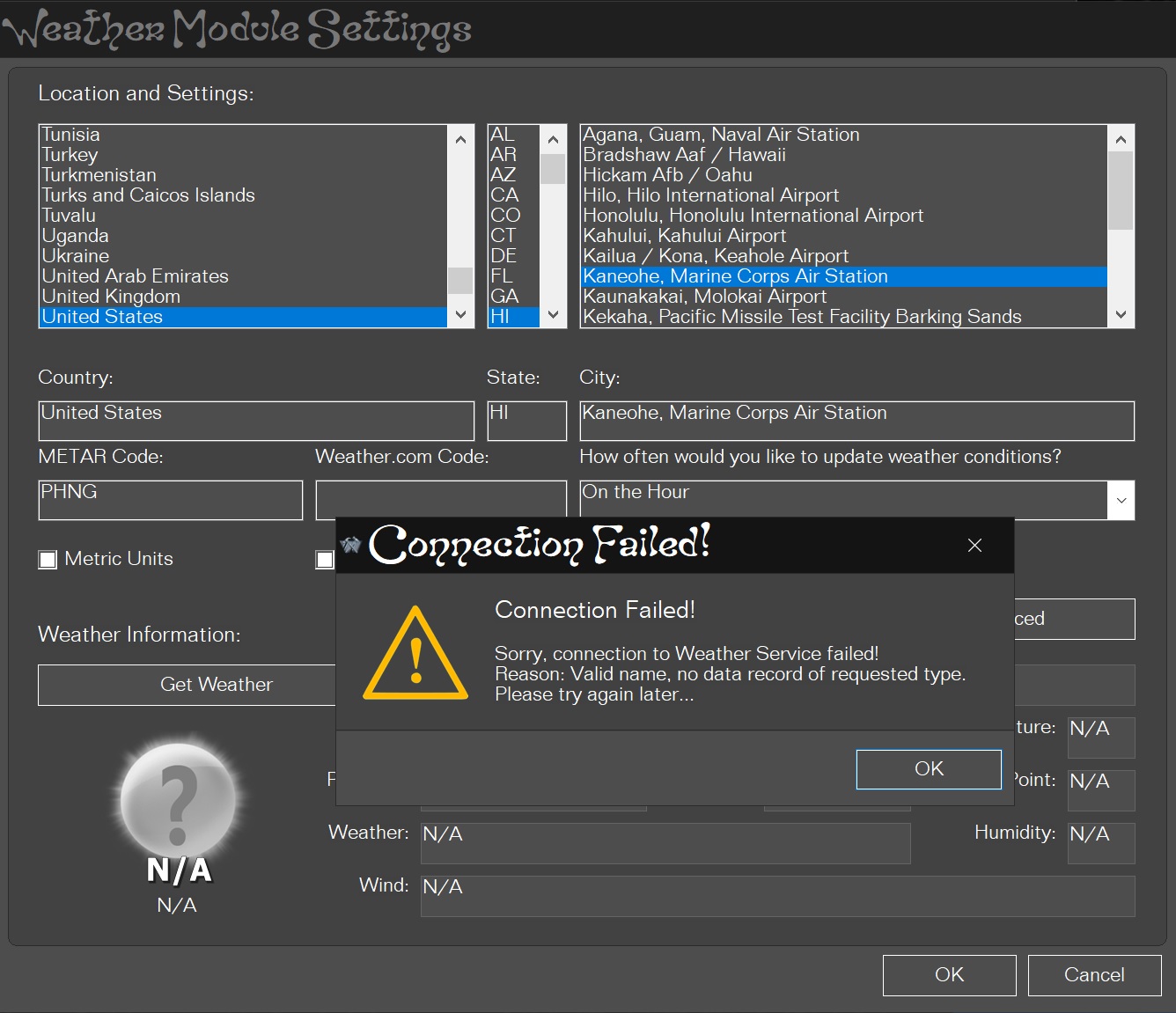

I am running Windows 10 updated to current date,
Purchased Winstep Xtreme 22.7 and a few days ago I noticed I was getting a N/A all the time from my weather module,
I have the advanced settings set to default, which I have attached. METAR source URL: is: https://tgftp.nws.noaa.gov/data/observa ... /stations/%1.TXT
I have tried it with and with out both my VPN and Firewall with the same results.
I am in Hawaii if that matters at all, but I have tried California settings to no avail.
I have read other posts on weather settings, and I have made sure that my *Windows* region is set correctly to English (US).
My Weather.log reads:
* METAR Connection Failed...
No Valid Codes
No Valid Codes
* MSN Connection Failed...
Host not found.
Host not found.
* Yahoo Connection Failed...
Valid name, no data record of requested type.
My METAR code is set to Honolulu International Airport: PHNL
Please advise!

I think the problem is not the weather module, but something on your system preventing the Winstep application from accessing the Internet.
Try this: open WorkShelf Preferences, go to the Advanced tab, click the Troubleshooting Options button, then click the Check Internet Connection button. What does it say?

Ok, So I tried that and here's a screen shot of what it says (at the bottom):
Strange,
I have tried to access the weather with METAR with my VPN and Firewall off as well, and I have made sure my regional settings are set to English US as well.
I still get this message:
