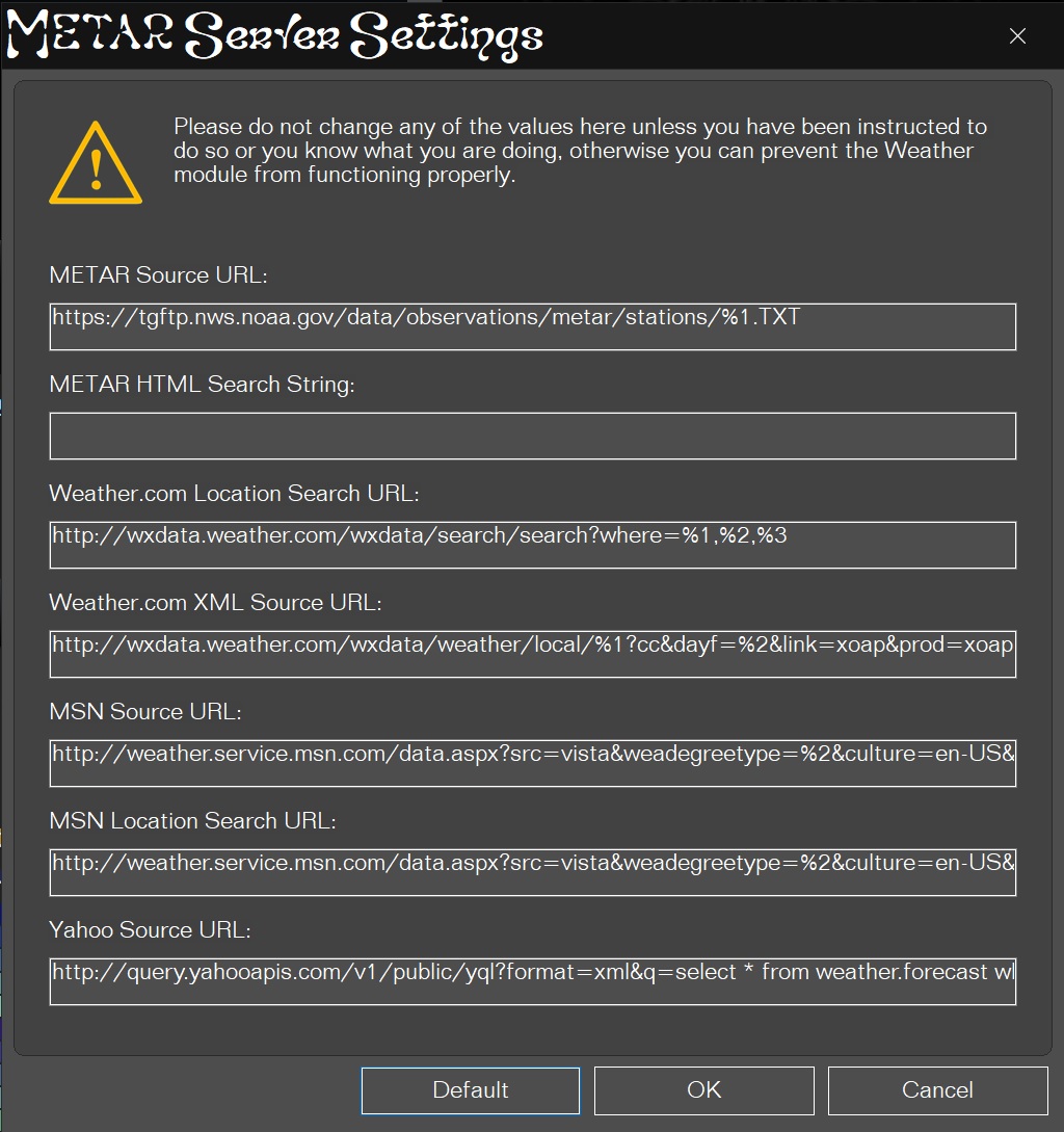

I am running Windows 10 updated to current date,
Purchased Winstep Xtreme 22.7 and a few days ago I noticed I was getting a N/A all the time from my weather module,
I have the advanced settings set to default, which I have attached. METAR source URL: is: https://tgftp.nws.noaa.gov/data/observa ... /stations/%1.TXT
I have tried it with and with out both my VPN and Firewall with the same results.
I am in Hawaii if that matters at all, but I have tried California settings to no avail.
I have read other posts on weather settings, and I have made sure that my *Windows* region is set correctly to English (US).
